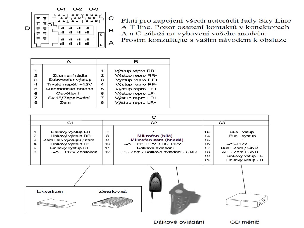

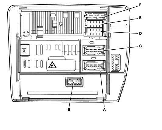

U Beckeru ( ICS ) bude obdoba vstupu a výstupu jako u Blaupunktu viz obr. Schéma zapojení ICS tu někde bylo, jednalo se o výtažek z eLearnu (servisní manuál pro 166)
EDIT
ICS EXTERNAL CONNECTOR "A" (BLACK)
A1, RGB for navigation (red)
A2, RGB for navigation (green)
A3, Not connected
A4, Not connected
A5, Not connected
A6, Terminal 31 for ICE electronic control unit
A7, Spare
A8, Spare
A9, Spare
A10, Navigation control signal
A11, Instrument light dimmer (from the vehicle)
A12, Spare
A13, Terminal 30 for ICS electronic control unit
A14, RGB for navigation (blue)
A15, RGB for navigation (synchronized signal)
A16, Earh for navigation video signals
A17, Not connected
A18, Not connected
A19, Terminal 31 for ICS electronic control unit
A20, Transmission to the instruments
A21, Reception from the instruments
A22, Spare
A23, Fuel consumption signal
A24, Vehicle speed signal
A25, Spare
A26, Terminal 30 for ICS electronic control unit
A/C INTERFACE WITH ICS CONNECTOR (WHITE)
B1, Terminal 30 for A/C interface
B2, Terminal 15 (detection signal only)
B3, Key contact
B4, Vehicle speed signal
B5, Instrument light dimmer (from the vehicle)
B6, Spare
B7, Terminal 31 for A/C interface
B8, A/C - ICS interface control bus
B9, A/C - MCC80A interface control bus
B10, Fuel level sensor positive pole
B11, Fuel level sensor negative pole
B12, Spare input (optional)
B13, Spare input (optional)
B14, Spare
ICS EXTERNAL CONNECTOR "C" (GREEN)
C1, Diagnostic interface
C2, Terminal 15 (detection signal only)
C3, Key contact
C4, Navigation control bus (transmission)
C5, Not connected
C6, DSP control bus earth
C7, Hands-free microphone earth
C8, Telephone microphone receiver
C9, Telephone receiver speaker
C10, Telephone receiver supply
C11, Spare
C12, Navigation audio signal earth
C13, Navigation audio signal
C14, DSP control bus
C15, A/C - ICS interface control bus
C16, Spare
C17, Navigation control bus (reception)
C18, Spare
C19, Spare
C20, Hands-free microphone
C21, Telephone receiver earth
C22, Telephone receiver hook contact
C23, Spare
C24, Spare
C25, Spare
C26, Spare
EXTERNAL AUDIO CONNECTOR "A"
D1, Vehicle speed signal
D2, Spare
D3, Telephone mute for external devices
D4, Terminal 30 for audio module
D5, Active aerial supply
D6, Spare
D7, Spare
D8, Terminal 31 for audio module
EXTERNAL AUDIO CONNECTOR "B"
E1, Right rear speaker positive
E2, Right rear speaker negative
E3, Right front speaker positive
E4, Right front speaker negative
E5, Left front speaker positive
E6, Left front speaker negative
E7, Left rear speaker positive
E8, Left rear speaker negative
Compartment "C1" (yellow)
F1, Left rear external line
F2, Right rear external line
F3, AF earth
F4, Left front external line
F5, Right front external line
F6, Sound amplifier positive
Compartment "C2" (green)
F7, CD reader control line
F8, CD reader supply (socket after the inductor)
F9, Spare
F10, Single dialogue data line (bus unilink)
F11, Single dialogue clock line (bus unilink)
F12, Single dialogue reset line (bus unilink)
F13,
F14,
F15,
F16,
F17,
F18, CD AF earth
F19, left CD AF earth
F20, right CD AF earth
zadni strana ICS
zadni strana ICS
Blaupunt
Blaupunt

Mal som doma klasický Iso konektor
z ktorého som poviťahoval tie piny a po menšej úprave som tie nastrkal do ICS :-D
Erik166 píše:lenze ked chcem cez zosik napojit aj repro vo dverach musel by som natahat kable po celom aute???. a co sa tyka subwofera , ako to cele vyladim ked v ICS neni ekvalizer ktory ma zvlast nastavenie pre subik?
Jojo musel by si naťahať od zosíku nové káble do dverí.A čo sa týka vyladenia tak normálne ekvalizér v ICS funguje aj cez linkový výstup a takisto na zosíku si to vyladíš :)
